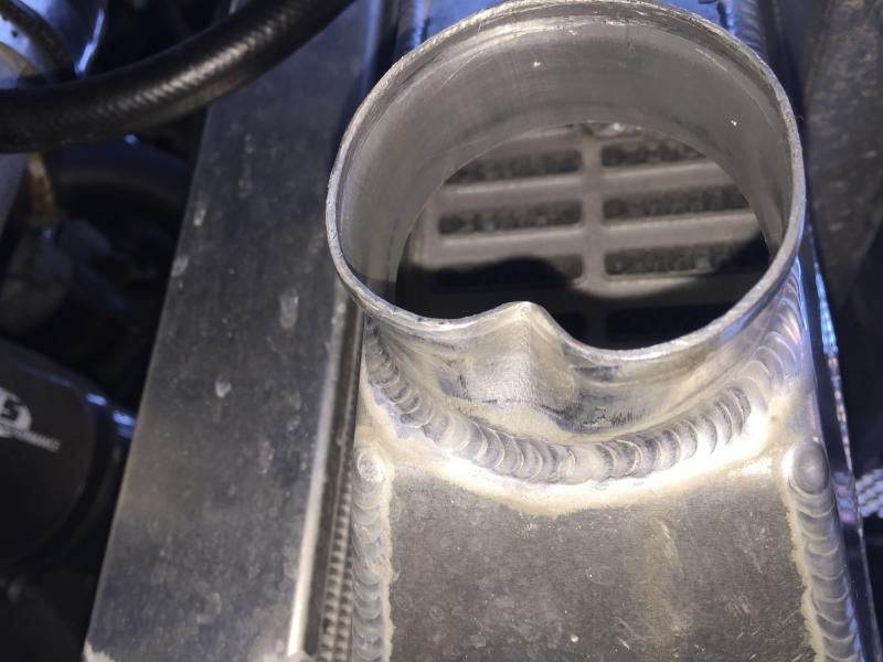

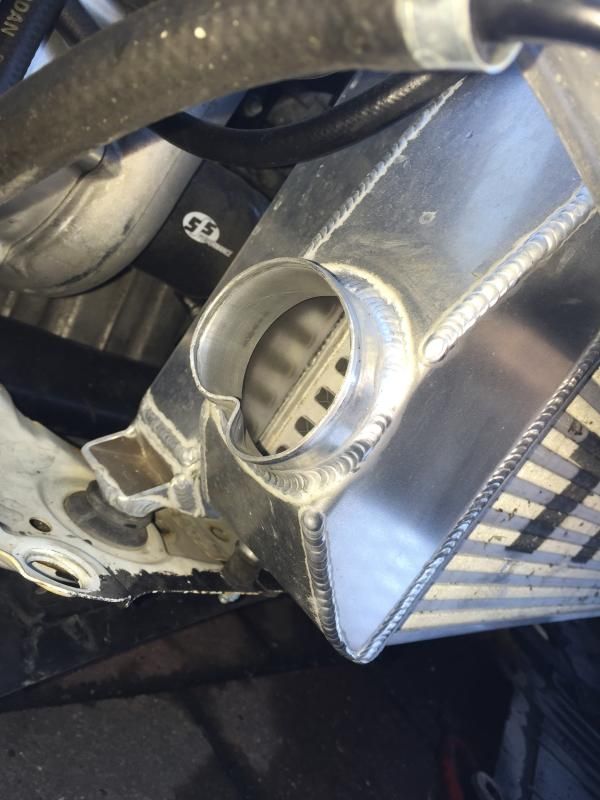

looking like a trip to romains in order. especially after finding this abomination, im almost in disbelief
had to replace the knock sensor and dropped a nut in the bay, so i ended up taking the bumper off and a boost pipe to check it hadn't fell anywhere near the charger and could not believe my eyes.
i emailed tts about this and he can't seem to understand that this has been done at his workshop and mapped like this with a potential boost leak and the air flow restriction it may cause. pondering my next move in light of all this
That's bad :( Look on the bright side though - a properly fitting pipe is probably gonna get you another 25 brake :)
That damage can only be done by someone or before fitting no way has that been done while on the car what a shocker at least you seen it now and can be fixed.
